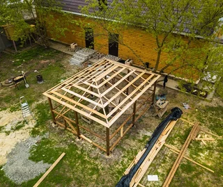

When the contractor quits before the project is finished, does the building permit still remain active, or does the homeowner have to apply for another permit? My gazebo project has turned into a nightmare. I can't blame the contractor for taking a more lucrative job, but it sure has put us in a tough spot.
